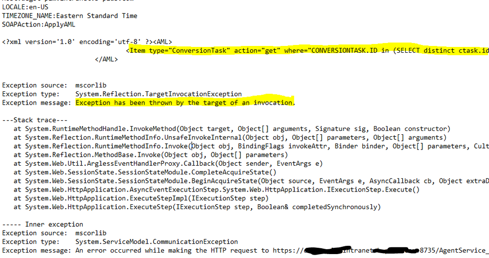

I did some maintenance checks and discovered that my Innovator\Server\temp folder contains log files with an error message that occurs once a day:
The bug looks like this:
Is anyone familiar with this bug and knows how to solve it? Error message looks like this:
Exception message: An error occurred while making the HTTP request to xyz.intranet.mycompany.com:8735/AgentService_xyz. This could be due to the fact that the server certificate is not configured properly with HTTP.SYS in the HTTPS case. This could also be caused by a mismatch of the security binding between the client and the server.

The log file shows the SQL query it tries to execute. I looks for the id of ConversionTask that are "In Progress" and where the "OnConvert" event is either "NotStarted" or in "In Progress". What does Innovator try to do here? Is it a check for tasks that run into timeout?
