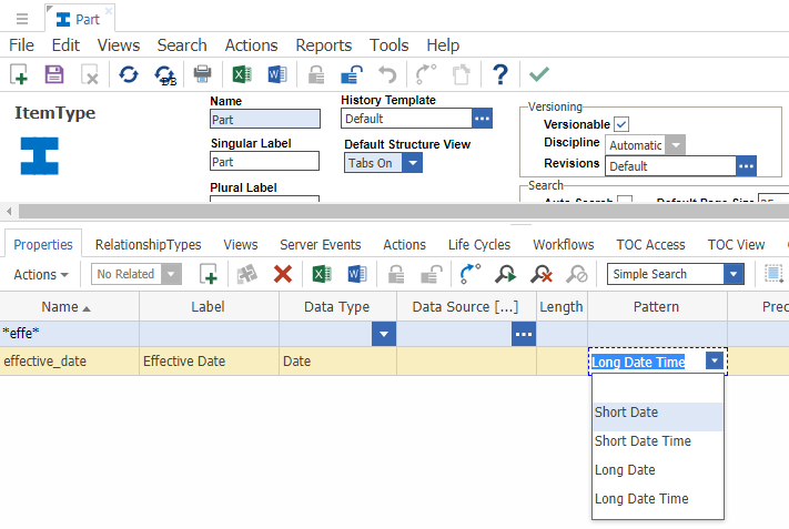

  • Hi
    You can configure the time in the Item Type.
    Long Date: Tuesday, January 14, 2019
    Short Date: 1/14/2019
    Short Date Time: 1/14/2019 9:30:43 PM (Allows User to Select Time)
    Long Date Time: Tuesday, January 14, 2019 9:31:41 PM (Allows User to Select Time)

      This works for properties that are bound to an Item Type. But when you are creating  a custom form and use a Date control in it, the default calendar that opens when clicking on the icon does not have Time field enabled... Any thoughts?
