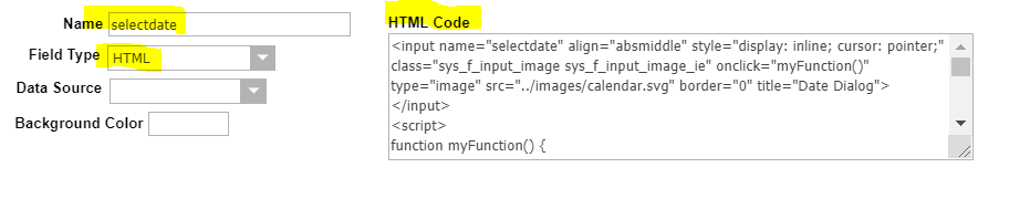

- Gopikrishnan6 years agoAccelerator II
Hi Neha
You can use below html in form to get the custom date format
Step 1: In form create two fields (text and html)
Step 2: For Text field, give name as date and Label as Date
Step 3: For HTML field, give name as selectdate and Label as Empty
Step 4: Copy below HTML code
<input name="selectdate" align="absmiddle" style="display: inline; cursor: pointer;" class="sys_f_input_image sys_f_input_image_ie" onclick="myFunction()" type="image" src="../images/calendar.svg" border="0" title="Date Dialog">
</input>
<script>
function myFunction() {
var dateFormat = "dd/MM/yyyy";
params = {
aras: top.aras,
format: dateFormat,
type: "Date"
return aras.getMainWindow().main.ArasModules.Dialog.show("iframe", params).promise.then(function(res) {
return updateDatetoText(res);
function updateDatetoText(dt) {
var queryDate = dt.replace(" ", "T");
var fillFromDate = document.querySelector("input[name='date']");
fillFromDate.value = queryDate;
</script>Thank You
Gopikrishnan R
