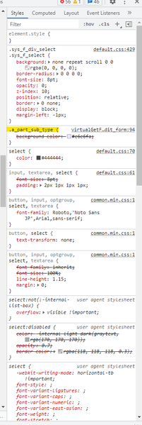

I did see this however I was looking to have it as a dropdown rather than a list box. Essentially I need the field to be colored in as if it were required but isn't actually required.

Dropdowns are bit special. There is the mighty Aras labs sample were they complete 'overchanged' the Form just to show that they can: https://github.com/ArasLabs/custom-form-css
Guess this one was the dropdown but not sure:
/* style dropdown */
${this field rule} .aras-filter-list__input{
}If you have access to Innovator 14. To what I have heard they changed the default Form layout. Not massive (size still the same) but in a way it´s looks less like 2000s.

Thank you, I think for now we will go with a note that the user needs to input a value on add. We have other processes that create this item without a value for this property so setting it to required is not an option unfortunately.
