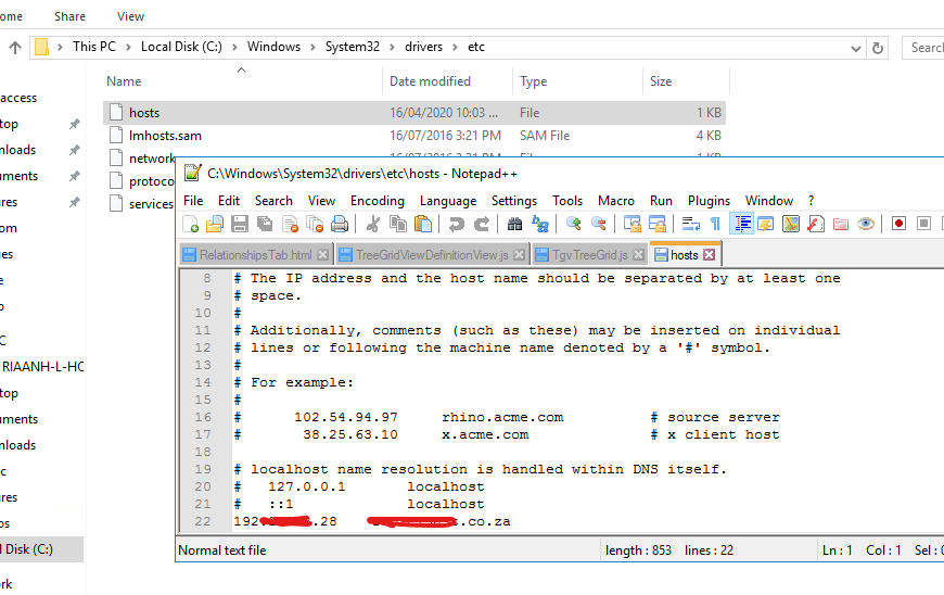

Hi Angela,
What he did was to add the IP and URL for our server into the "host" file as such:
I hope it helps!
Regards
