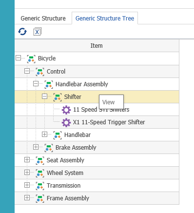

Can't view item from tree grid view
Hello
I'm new to Aras and I have a problem with a tree grid view that I have added to the generic items that were included in the variant manager sample application. I followed the tutorial "An Introduction to Query Builder and Tree Grid View" to make a tree grid view showing the structure of the generic items and what parts were connected to each generic item as usage cases.
My problem is that i can't open the parts/generic items from the tree grid view, I get the option in the context menu but it's greyed out and can't be selected. How can I enable this option? I'm logged in using the administrator account.

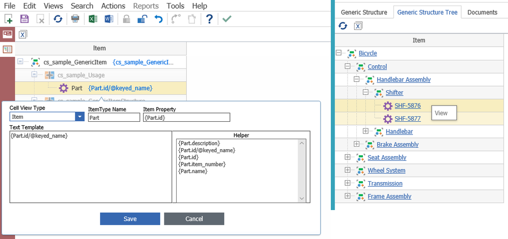

  • What cell view type do you use? Just Text or Item?
    • RickP's avatar
      RickP
      I was using text, changing it to item and defining the type and property allowed me to open the items by left clicking on the blue item link. The right click context menu is still greyed out. Thanks for the tip, now I can use the tree to browse the structure, though ideally I'd like to be able use the context menu as well.
