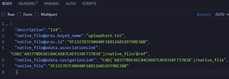

Can native_file id property be updated via REST?
I want to use the REST api to attach a file to the native_file property of an object, for example a CAD Document.
I can PATCH regular properties in and it takes it, but wont assign the native_file.
take a PATCH to /CAD('<id>')
    "[email protected]" : "52251F9581754C038AFB2B10227A72CA"
returns 200 success, but does not set the property.
    1 year ago
    I tried this old sample of mine and it worked fine:
    If it works for you, please tell me which parts of the body are actually needed [emoticon:6d505171faa4497c85c5ca27290c555d].
