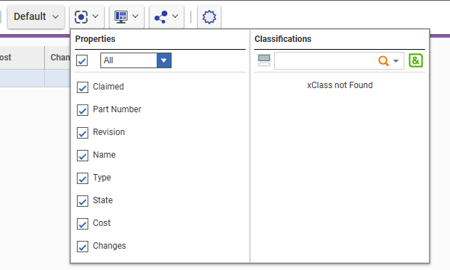

Can I display properties in alphabetical order in refine?
If yes, please let me know.
    The view uses the default sort_order as specified in your ItemType.
    You can modify ..Innovator\Client\Modules\aras.innovator.ExtendedClassification\scripts\BaseColumnSelectionMediator.js
    But I wouldn´t recommend general alphabetical sorting. The current sorting represents the grid order, which is most of the time quite helpful.
    Personally I would rather add some additional button to the dialog that offer additional sort options on demand:
    1. One button for optional alphabetical sorting
    2. Second button to show the original database name of the property (mainly for admins :) ).
