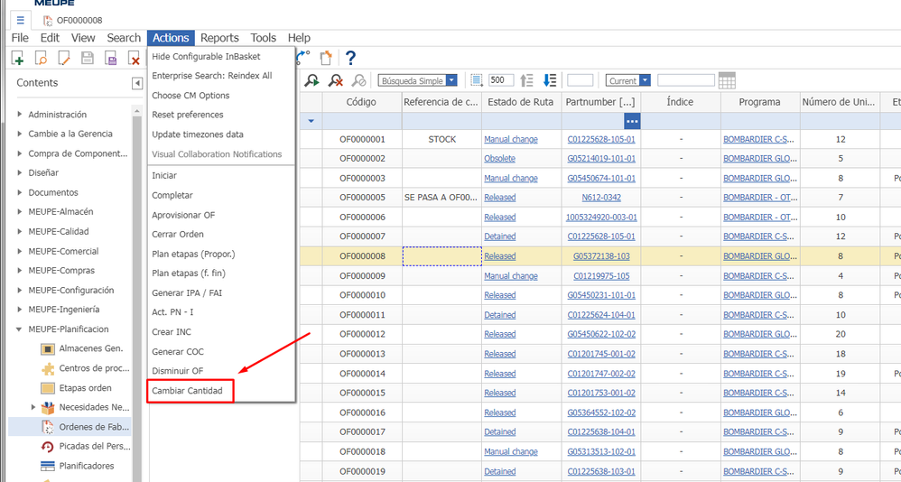

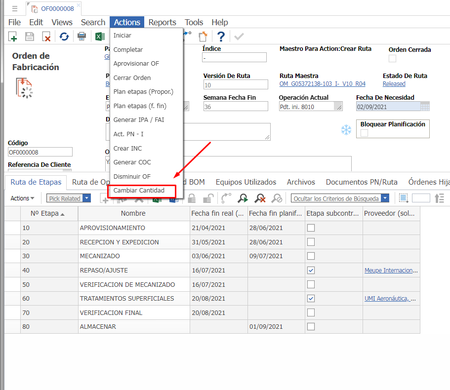

Calling Action from a grid or a form. May I know where I call from?.
Hello, I have a question, I have an "Action" which I can call either from the menu, the grid, or from the form. Is there any way to know from where I call that "Action"?. I need to differentiate it to execute one part of the code or another.

    This variant can be used for Form and Actions. This combination would only allow JS:
    let myItem;
    if (parent.thisItem === undefined){
        myItem = this; // Action call
    else
        myItem = parent.thisItem; // form call
    return aras.AlertError(myItem.getProperty("name"));

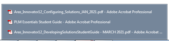

      One question, is there any help where I can see all the methods, etc, that exist in ARAS? I have 3 PDFs, but it is not complete.
      For example of aras.uiReShowItem I have not found anything in any PDF, only in the forum.

        Unfortunately JavaScript related function often is not documented at all. But don´t worry to much about it.
        The forum is an excellent source for stuff not covered in the official docs. As additional useful resource I can recommend the "aras programmers guide". It contains a lot of useful samples. You can google it.
        There are API references inside Innovator and some are also listed here: https://cylnote.blogspot.com/search/label/API%20Reference
