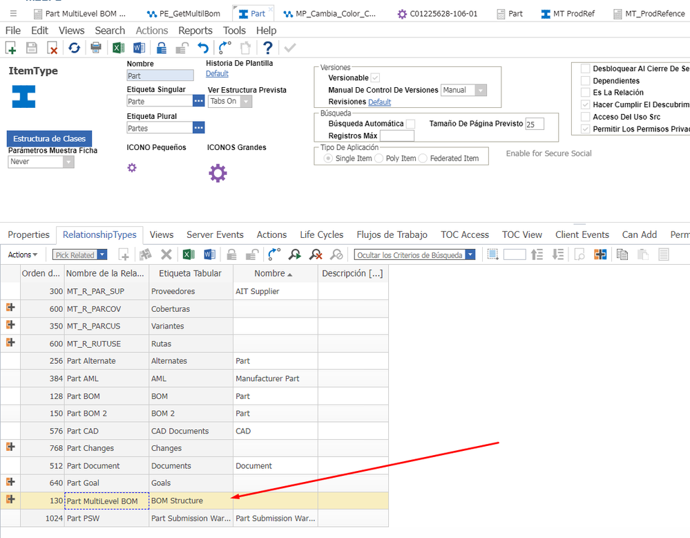

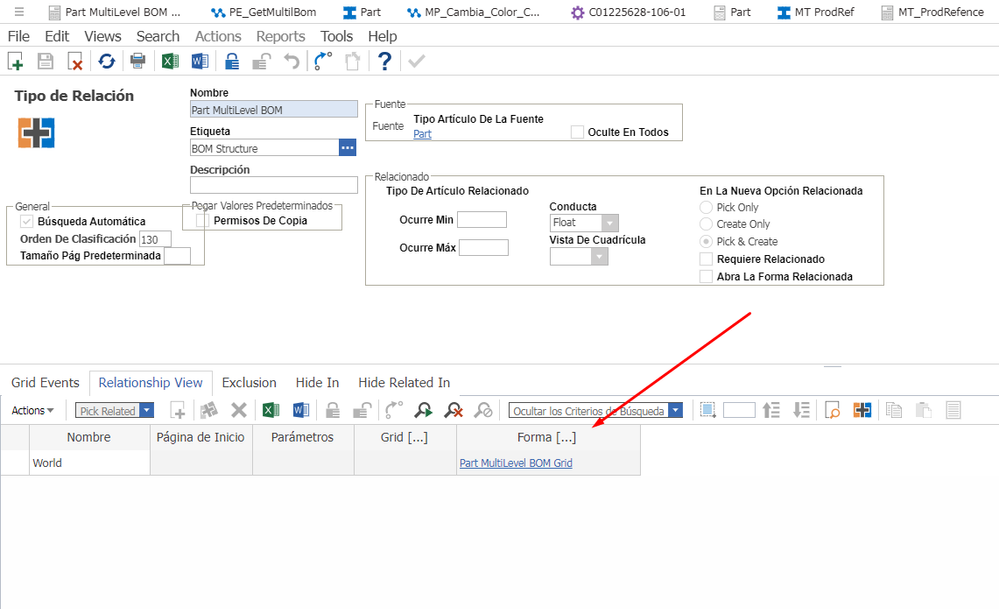

    Can you make a screenshot of the Realtionship View tab? What is used there to render the view? You mentioned the Form "Part MultiLevel BOM Grid". Is this one linked? I expected something in the "Start Page" column.
      team_aras_meupe_com
      Creator III

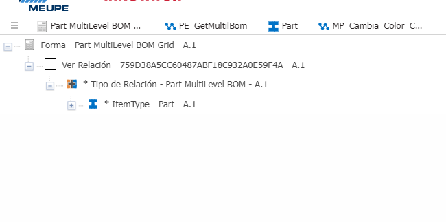

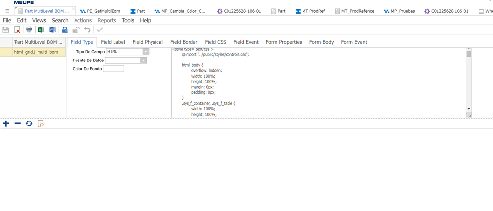

      Hello Angela, yes, here are some pics!!:
      Code of this HTML:
      [embed:dc8ab71f-3b98-42d9-b0f6-e21e02a0f8e2:15fdd54c-8fe1-40d9-9d96-f43adb8f9239:type=xml&text=%3Cstyle%20type%3D%22text%2Fcss%22%3E%0A%09%40import%20%22..%2Fpublic%2Fstyles%2Fcontrols.css%22%3B%0A%09%0A%09html%2C%20body%20%7B%0A%09%09overflow%3A%20hidden%3B%0A%09%09width%3A%20100%25%3B%0A%09%09height%3A%20100%25%3B%0A%09%09margin%3A%200px%3B%0A%09%09padding%3A%200px%3B%0A%09%7D%0A%09.sys_f_container%2C%20.sys_f_table%20%7B%0A%09%09width%3A%20100%25%3B%0A%09%09height%3A%20100%25%3B%0A%09%7D%0A%3C%2Fstyle%3E%0A%3Cscript%20type%3D%22text%2Fjavascript%22%20src%3D%22..%2Fjavascript%2Finclude.aspx%3Fclasses%3DXmlDocument%22%3E%3C%2Fscript%3E%0A%3Cscript%20type%3D%22text%2Fjavascript%22%3E%0A%09var%20grid%3B%0A%09var%20toolbar%3B%0A%0A%09var%20innovator%20%3D%20new%20top.Innovator%28%29%3B%0A%09var%20partItemType%20%3D%20top.aras.getItemTypeForClient%28%22Part%22%2C%20%22name%22%29%3B%0A%09var%20Part_rowIcon%20%3D%20partItemType.getProperty%28%22open_icon%22%29%3B%0A%09var%20xmlFileBase%20%3D%20top.aras.getScriptsURL%28%29%20%2B%20%22..%2FSolutions%2FPLM%2Fxml%2F%22%3B%0A%09var%20xmlParentBase%20%3D%20top.aras.getScriptsURL%28%29%20%2B%20%22..%2FSolutions%2FPLM%2F%22%3B%0A%09var%20currentUserID%20%3D%20top.aras.getCurrentUserID%28%29%3B%0A%0A%09top.aras.registerEventHandler%28%22ItemSave%22%2C%20window%2C%20ItemSaveListener%29%3B%0A%0A%09window.onresize%20%3D%20fixGridHeight%3B%0A%0A%09function%20ItemSaveListener%28params%29%20%7B%0A%09%09if%20%28%21document.thisItem%20%7C%7C%20document.thisItem.getId%28%29%20%21%3D%20params.itemID%29%20%7B%0A%09%09%09return%3B%0A%09%09%7D%0A%09%09initTree%28%29%3B%0A%09%7D%0A%0A%09var%20onload_handler%20%3D%20function%20%28%29%20%7B%0A%09%0A%09%09clientControlsFactory.createControl%28%22Aras.Client.Controls.Public.Toolbar%22%2C%20%7B%20id%3A%20%22bom_toolbar%22%2C%20connectId%3A%20%22toolbarContainer%22%20%7D%2C%20function%20%28control%29%20%7B%0A%09%09%09%09toolbar%20%3D%20control%3B%0A%09%09%09%09clientControlsFactory.on%28control%2C%20%7B%22onClick%22%3A%20onToolbarButtonClick%7D%29%3B%0A%09%09%09%09initToolbar%28%29%3B%09%0A%09%09%7D%29%3B%0A%09%09%09%0A%09%09clientControlsFactory.createControl%28%22Aras.Client.Controls.Public.TreeGridContainer%22%2C%20%20%7BconnectId%3A%20%22grid%22%2C%20canEdit_Experimental%3A%20function%20%28%29%20%7B%20return%20false%3B%20%7D%7D%2C%20function%28control%29%20%7B%0A%09%09%09grid%20%3D%20control%3B%0A%09%09%09grid.setMultiselect%28false%29%3B%0A%09%09%09clientControlsFactory.on%28grid%2C%20%7B%0A%09%09%09%09%22gridClick%22%3A%20onGridClick%2C%0A%09%09%09%09%22gridDoubleClick%22%3A%20onGridDoubleClick%2C%0A%09%09%09%09%22gridMenuInit%22%3A%20onGridMenuInit%2C%0A%09%09%09%09%22gridMenuClick%22%3A%20onGridMenuClick%0A%09%09%09%7D%29%3B%0A%09%09%09initTree%28%29%3B%0A%09%09%09fixGridHeight%28%29%3B%0A%09%09%7D%29%3B%0A%09%7D%0A%0A%0A%09function%20fixGridHeight%28%29%20%7B%0A%09%09var%20el%20%3D%20document.getElementById%28%22grid%22%29%3B%0A%09%09top.aras.fixLiquidContainerHeight%28document%2C%20el%29%3B%0A%09%7D%0A%0A%09window.addEventListener%28%22DOMContentLoaded%22%2C%20onload_handler%29%3B%0A%0A%09function%20initTree%28%29%20%7B%0A%09%09if%20%28%21document.item%29%20%2F%2FView%20form%20in%20FormTool%0A%09%09%7B%0A%09%09%09return%3B%0A%09%09%7D%0A%0A%09%09var%20resItem%20%3D%20innovator.newItem%28%22Part%22%2C%20%22PE_GetMultilBom%22%29%3B%0A%09%09resItem.setID%28document.item.getAttribute%28%22id%22%29%29%3B%0A%09%09resItem%20%3D%20resItem.apply%28%29%3B%0A%09%09if%20%28resItem.isError%28%29%29%20%7B%0A%09%09%09top.aras.AlertError%28resItem.getErrorString%28%29%29%3B%0A%09%09%09return%3B%0A%09%09%7D%0A%0A%09%09grid.InitXML%28resItem.getResult%28%29%29%3B%0A%09%7D%0A%0A%09function%20getItemTree%28itemID%2C%20queryLevel%29%20%7B%0Adebugger%3B%0A%09%09var%20treeLoadXml%20%3D%20top.aras.createXMLDocument%28%29%3B%0A%09%09treeLoadXml.load%28xmlFileBase%20%2B%20%22query.xml%22%29%3B%0A%09%09if%20%28treeLoadXml.parseError.errorCode%20%21%3D%200%29%20%7B%0A%09%09%09var%20loadError%20%3D%20treeLoadXml.parseError%3B%0A%09%09%09top.aras.AlertError%28%22You%20have%20error%3A%5Cn%22%20%2B%20loadError.reason%29%3B%0A%09%09%09return%3B%0A%09%09%7D%0A%09%09var%20partBom%20%3D%20treeLoadXml.selectSingleNode%28%22Item%2FRelationships%2FItem%5B%40repeatTimes%5D%22%29%3B%0A%09%09partBom.setAttribute%28%22repeatTimes%22%2C%20queryLevel%29%3B%0A%0A%09%09var%20query%20%3D%20innovator.newItem%28%29%3B%0A%09%09query.loadAML%28treeLoadXml.xml%29%3B%0A%09%09query.setID%28itemID%29%3B%0A%09%09var%20results%20%3D%20query.apply%28%29%3B%0A%09%09if%20%28results.isError%28%29%29%20%7B%0A%09%09%09top.aras.AlertError%28results.getErrorString%28%29%29%3B%0A%09%09%09return%3B%0A%09%09%7D%0A%09%09return%20results%3B%0A%09%7D%0A%0A%09%2F%2F%20%3D%3D%3D%3D%3D%3D%3D%3D%3D%3D%3D%3D%3D%3D%3D%3D%3D%3D%3D%3D%3D%3D%3D%3D%3D%3D%3D%3D%3D%20Toolbar%20%26%20Menu%20%20Handlers%20%3D%3D%3D%3D%3D%3D%3D%3D%3D%3D%3D%3D%3D%3D%3D%3D%3D%3D%3D%3D%3D%3D%3D%3D%3D%3D%3D%3D%3D%3D%3D%0A%0A%09function%20initToolbar%28%29%20%7B%0A%09%09document.toolbar%20%3D%20toolbar%3B%0A%09%09toolbar.loadXml%28top.aras.getI18NXMLResource%28%22MultiLevelBomToolbar.xml%22%2C%20%22..%2FSolutions%2FPLM%2F%22%29%29%3B%0A%09%09toolbar.show%28%29%3B%0A%09%7D%0A%0A%09function%20setControlEnabled%28ctrlName%2C%20b%29%20%7B%0A%09%09if%20%28%21toolbar%29%0A%09%09%09return%3B%0A%0A%09%09if%20%28b%20%3D%3D%3D%20undefined%29%0A%09%09%09b%20%3D%20true%3B%0A%09%09else%0A%09%09%09b%20%3D%20Boolean%28b%29%3B%0A%0A%09%09var%20AT%20%3D%20toolbar.getActiveToolbar%28%29%3B%0A%09%09var%20tbi%20%3D%20AT.getElement%28ctrlName%29%3B%0A%09%09if%20%28tbi%29%0A%09%09%09tbi.setEnabled%28b%29%3B%0A%09%7D%0A%0A%09function%20onToolbarButtonClick%28item%29%20%7B%0A%09%09var%20btnId%20%3D%20item.getId%28%29%3B%0A%09%09if%20%28%22expandall%22%20%3D%3D%20btnId%29%0A%09%09%09onExpandAll%28%29%3B%0A%09%09else%20if%20%28%22collapseall%22%20%3D%3D%20btnId%29%0A%09%09%09onCollapseAll%28%29%3B%0A%09%09else%20if%20%28%22refresh%22%20%3D%3D%20btnId%29%0A%09%09%09initTree%28%29%3B%0A%09%09else%20if%20%28%22open_row_item%22%20%3D%3D%20btnId%29%0A%09%09%09onOpenRowItem%28%29%3B%0A%09%7D%0A%0A%09function%20onGridMenuInit%28row%2C%20col%2C%20p%29%20%7B%0A%09%09var%20mnu%20%3D%20grid.getMenu%28%29%3B%0A%09%09mnu.removeAll%28%29%3B%0A%09%09mnu.add%28%22open_row_item%22%2C%20%22Open%20Item%22%29%3B%0A%09%09mnu.menu.startup%28%29%3B%0A%09%7D%0A%0A%09function%20onGridMenuClick%28menuChoice%2C%20rowId%2C%20col%29%20%7B%0A%09%09if%20%28%22open_row_item%22%20%3D%3D%20menuChoice%29%0A%09%09%09onOpenRowItem%28rowId%29%3B%0A%09%7D%0A%0A%09function%20onExpandAll%28%29%20%7B%0A%09%09grid.expandAll%28true%29%3B%0A%09%7D%0A%0A%09function%20onCollapseAll%28%29%20%7B%0A%09%09grid.expandAll%28false%29%3B%0A%09%7D%0A%0A%09function%20onGridDoubleClick%28rowId%29%20%7B%0A%09%09onOpenRowItem%28rowId%29%3B%0A%09%7D%0A%0A%09function%20onGridClick%28rowId%2C%20column%29%20%7B%0A%09%09setControlEnabled%28%22open%22%2C%20true%29%3B%0A%09%7D%0A%0A%09function%20onOpenRowItem%28rowId%29%20%7B%0A%09%09if%20%28%21rowId%29%0A%09%09%09rowId%20%3D%20grid.getSelectedId%28%29%3B%0A%0A%09%09if%20%28%21rowId%29%0A%09%09%09return%3B%0A%0A%09%09var%20partId%20%3D%20grid.GetUserData%28rowId%2C%20%22gridData_rowItemID%22%29%0A%09%09top.aras.uiShowItem%28%22Part%22%2C%20partId%29%3B%0A%09%7D%0A%3C%2Fscript%3E%0A%0A%3Ctable%20class%3D%22claro%22%20style%3D%22width%3A%20100%25%3B%20height%3A%20100%25%3B%20position%3A%20absolute%3B%20top%3A%200px%3B%20left%3A%200px%3B%22%20cellspacing%3D%220%22%20cellpadding%3D%220%22%3E%0A%09%3Ctr%20style%3D%22vertical-align%3A%20top%3B%22%3E%0A%09%09%3Ctd%20id%3D%22toolbarContainer%22%3E%0A%09%09%3C%2Ftd%3E%0A%09%3C%2Ftr%3E%0A%09%3Ctr%20style%3D%22vertical-align%3A%20top%3B%22%3E%0A%09%09%3Ctd%20id%3D%22grid%22%20style%3D%22width%3A%20100%25%3B%20height%3A%20100%25%3B%22%3E%0A%09%09%3C%2Ftd%3E%0A%09%3C%2Ftr%3E%0A%3C%2Ftable%3E]
      In the line 75 calls to method PE_GetMultilBom.
