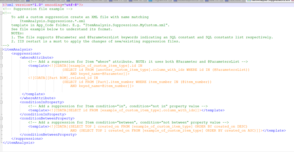

    • Ashok_Yadav's avatar
      Ashok_Yadav
      Hello Angelalp,
      Thank you for your reply.
      Please suggest me. How can i  customize ItemAnalysis.Suppressions.xml for mapping my requirement ?
      I  try below. but it is not work. please suggest me.
      Regards
      Ashok Kumar Yadav
        since all my years in Innovator I never was forced to use this file. Normally there is always a way to avoid these kind of queries.
        According to the xml, you have to create a copy of this template.
        I assume you have to but your custom query into the <whereAttribute> tag inside CDATA:
        <whereAttribute>
        <!-- Add a suppression for Item "where" attribute. NOTE: it uses both @Parameter and @ParametersList -->
        <template><![CDATA[
        [Part BOM].related_id=(select id FROM innovator.Part WHERE ITEM_NUMBER='424-01-00001' and IS_CURRENT='1')
        ]]></template>
        </whereAttribute>
        Maybe this is already enough to make your AML query work.
