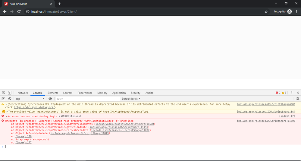

Blank page after installing and login to 12.0
Installed Aras 12.0 and I get following empty screen with js error after login.

  • I have exactly the same issue. Chrome browser - latest.
    Anyone have any ideas. I am unable to evaluate the product currently.

  • I also have the exact same issue, same error [Uncaught (in promise) TypeError: Cannot read property 'GetAllMetadataDates' of undefined]
    Any hint from the folks on this thread that found the fix?

    • discerning's avatar
      discerning
      Ideator II
      I finally fixed my issue. I am not an Aras "regular" and missed the very important details on which .Net & Core frameworks to install in the installation document. You MUST, very closely follow the links and description for the install machine. I had to try a number of times before finally getting it just right.
