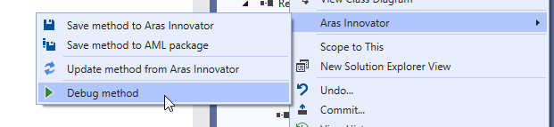

5. The Method is then tested using the NUnit.exe program or a repository script file."Regarding the visual studio add-in, I was able to extract a method from the server, modify it in Visual Studio and then push it to the server.
There's also a possibility to debug a method directly, Right click on the method, Debug (picture below).
This is quite nice.
However, the guide advise to have an instance of Aras on the same machine to do so. I tried with a server on another machine, and I was almost able to do it. In the end my local Visual Studio was unable to access the PDB from the server. I saw that there's a workaround by making the folder where the PDB are a share directory so we can access it locally. But I stopped at this step, because using a server that is not local to debug is not a good idea, since I'm not the only one to work on it, and when I debug and put a breakpoint, it stop everything for every users.
