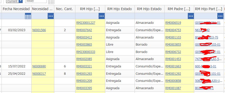

      Yess, too many thanks!!! it works fine:
      This is how the code has remained. What I have not been able to is to group the attributes in a single line. commented line number 15

        I agree the grouping doesn´t work. I don´t know why, I would prefer to group the CSS classes too. CSS itself supports this, but Innovator don´t.
        Some hint: The CSS property can store only limited content. Remove all spaces you don´t need. Close each class section with a semicolon “;”.  Keep it as compact as possible.
        Something like this ->  newCss = ".state{font-color:" + bg_color_state + ";}";
