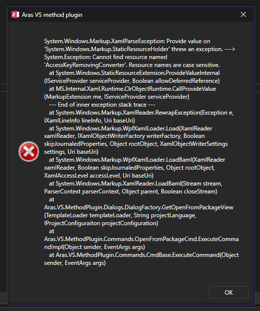

Hi there,

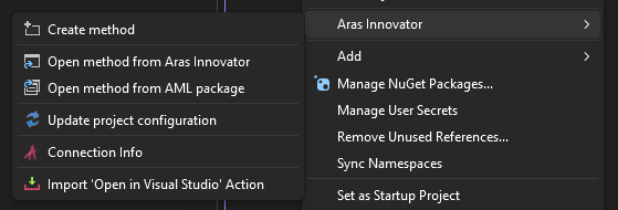

I have installed this extension into Visual Studio 2026, but no matter which of the functions I try to use, I get an exception like the one shown. The installation reported no problems and I am able to create a new project from a template. Yet setting up the connection or creating a new method gives exceptions.
Are anyone using this without problem?
Are there any 'hacks' to adding the connection info manually?
