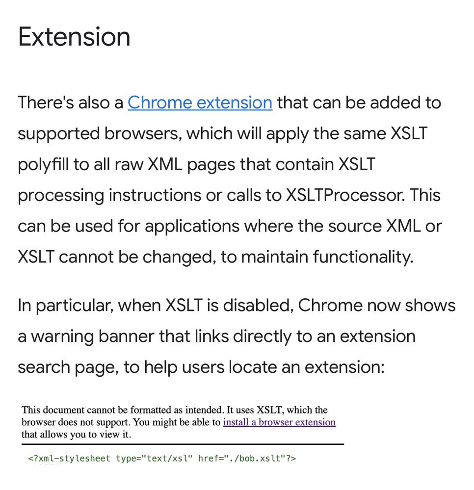

- PLMForgeIdeator III
For those interested in more info on the depreciation of XSLT in chrome as well as chromes guidance on migration for developers who utilize the browsers XSLT API.
https://developer.chrome.com/docs/web-platform/deprecating-xslt#:~:text=Chromium%20has%20officially%20deprecated%20XSLT,XSLT%20from%20their%20browser%20engines.
One potential migration path they reference is a Chrome extension that would polyfill any use of the old XSLT API for web apps that users don’t have permission to change, and might work as a temporary fix for some users if Aras does not provide a hotfix for their version Aras Innovator.

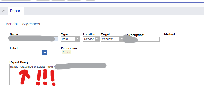

I just created a standard SSRS Report in for Innovator and noticed something interesting. Even regular SSRS reports will be affected! Well, not the reports directly, but the way we call them from Innovator.
Aras will have to reinvent the complete Report ItemType!!!! For SSRS we can still use Methods as fallback if no patch is available. But the patching they will have to do is massive!
For people who are not prepared, this will become Ara-Geddon! 🤣

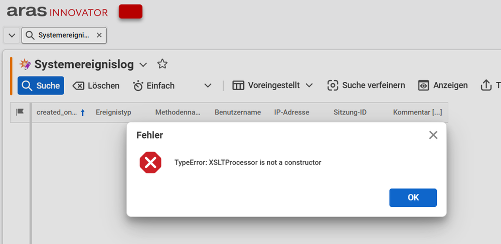

Some update:
- Aras is aware of the issue and works on it.
- I don´t have a patch yet.
- It´s unclear whether XSLT Reporting is still supported in the future.
The main question is not whether we will receive a patch for I14, but whether patches will also be provided for I12 and I11. There are still active subscribers using I12, while I11 is barely in use anymore.
There is a small risk that Aras will release the patch only for subscribers. However, this is not a major concern. Experience shows that such fixes usually find their way into the wider community sooner or later, and Aras is well aware of that.
More likely, the patch will be bundled with subscription-related marketing :)
