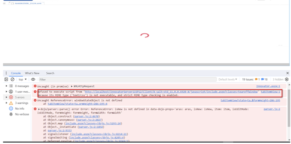

Where does the error message appear? Do you get it as pop-up when you try to upload a file?
Do you have a brand new installation? If yes, is Vault configured correctly in code tree and database?
Or does the error appear in an existing installation? In this case, does the error message only appear for CSS files? There are some mime type related settings in VaultServer\web.config which may have some influence. The error message somehow indicates, that Innovator want to execute the CSS file, but the browser does not allow it. In this case you could try a custom case for css in the web.config.

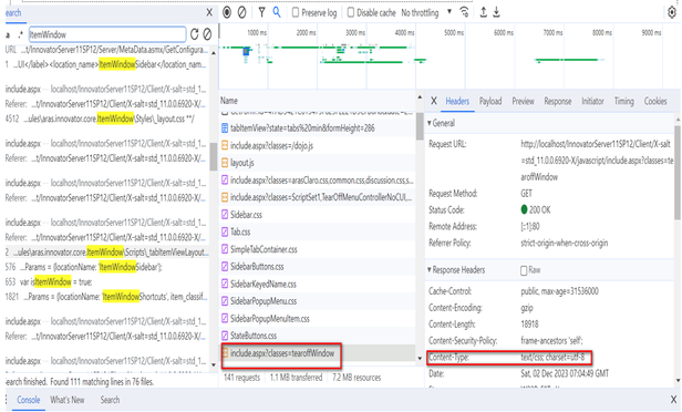

Q1. Where does the error message appear?
==> from Google Chrome browser console screen.
Q2. Do you get it as pop-up when you try to upload a file?
==> try to upload a file, just always waiting!
Q3. Do you have a brand new installation?
==> No
Q4. does the error appear in an existing installation?
==> Before add security header, that is ok!
Q5. There are some mime type related settings in VaultServer\web.config which may have some influence.
==> It is include.aspx generate error!

==> Before add security header, that is ok! --> This one is a bit unclear. Have you modified security headers in IIS?
Don´t be confused bei include.apsx error. That´s a general page. Error is caused probably by something else.
