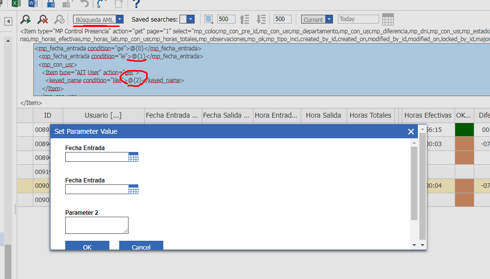

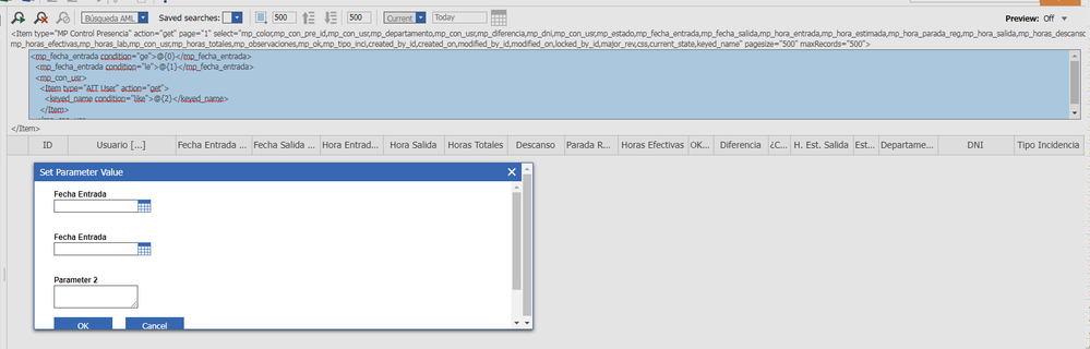

Hi, I'm trying to make AML queries with variables, like the ones in the photo. The only thing that I do not find is the key to put a personalized "label" for each field. It's possible?
As almost always, ARAs fails with the size of the dialog box.
This is the code.
<mp_fecha_entrada condition="ge">@{0}</mp_fecha_entrada>
<mp_fecha_entrada condition="le">@{1}</mp_fecha_entrada>
<mp_con_usr>
    <Item type="AIT User" action="get">
        <keyed_name condition="like">@{2}</keyed_name>
    </Item>
</mp_con_usr>

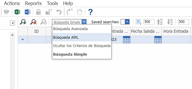

    To test this out: When you select a different search mode, do you have "AML" in addition to your "Busqueda AML" search mode?

      To test: I have the option ""busqueda AMl", i think in your system "AML Search" (Spanish translation), this is my options:
      It's a simple AML search, but in the search fields you put the code: @{0}
      <mp_entry_date condition="ge">@{0}</mp_entry_date>
      I see this search method quite well, especially for date ranges for "clumsy" users, who do not know how to delete dates, edit them, etc.
      You know, for the average user, it's easier for them to have a form appear and fill in the data.

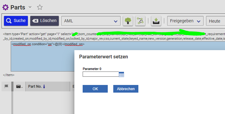

        I am shocked! I didn´t know that this kind of feature exists at all.[emoticon:44a8a53ad3364ea78a16c5a3229f75bb] The additional window seems to be triggernd when using date or other "hard to use" properties:
        The used label is definitely taken from the ItemType definition. When you assign a proper label in the ItemType, it will appear in the Form. If label is missing, it will just use Parameter 0/1/2.
        During my quick test I wasn´t able to determine, where the Form itself is specified. Maybe the AML search mode contains the answer. But the windows is triggernd when clicking "Search", so it´s probably more related to the general search function. But I am just guessing.
