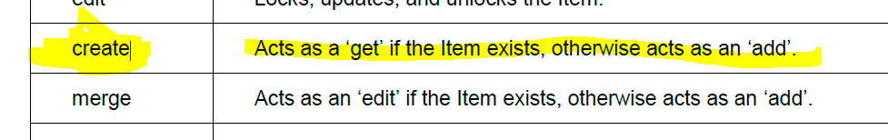

inside the programmers guide is following lists of actions:
Does anyone of you have a sample that shows how to use the "create" action? It should be similar to "merge" , but so far I wasn´t able to achieve a query that has the described behavior in the guide..
When I want to "create" an item that already exists, it doesn´t "get" the existing item. Instead Innovator complains that the item already exists. Just like it would do when using the regular "add" action.
So right now my "create" action behaves like a regular "add". Is the programmers guide wrong or do I just use "create" the wrong way? Does anyone know more about this one?

    so far I discovered that "Create" only seem to work for relationships actions. But I couldn´t use it for single item operations. I wonder if this is a bug or intended behavior.
