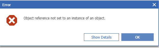

below the error when i click in the buuton:
Any help please ?
  • Problem resolved when adding the source-id.
