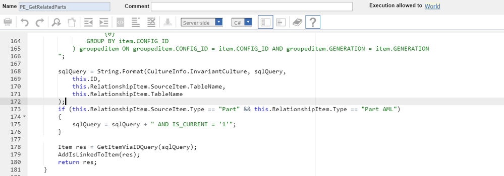

Above solution is applicable for ARAS V12 version. No Worries. Try below solution for V11
Step 1: Search and open PE_GetRelatedParts Method
Step 2: Go to line number 172 and add below if condition (highlighted text is the only change we need to include in this method).
sqlQuery = String.Format(CultureInfo.InvariantCulture, sqlQuery,
this.ID,
this.RelationshipItem.SourceItem.TableName,
this.RelationshipItem.TableName
if (this.RelationshipItem.SourceItem.Type == "Part" && this.RelationshipItem.Type == "Part AML")
sqlQuery = sqlQuery + " AND IS_CURRENT = '1'";
}Step 3: Save and unlock method
Try now and hit like if it works [emoticon:c4563cd7d5574777a71c318021cbbcc8]
