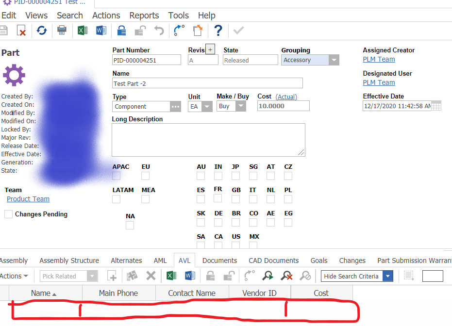

      • Parth's avatar
        Parth
        Ideator II
        Here Part number is a unique ID (part table). This table is linked to AVL. the task is to add vendor and cost for 150 unique part numbers. Considering 3columns:  part number (part table), vendor name (AVL table) and Cost (AVL table) - what should my query be ?
