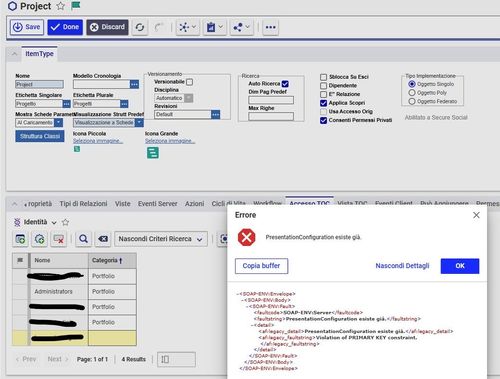

  I have this problem:
When I try to add a new user in the TOC access I have the error:
PresentationConfiguration already exists
I can't understand where is the problem, the presentation configuration is empty
Thanks

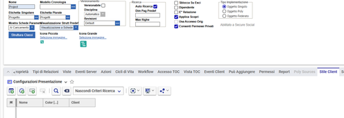

        is different because that time I had an entry in style client. Deleting it as you suggested it worked.
      This time style client is empty but I have an error anyway
        I assume the PresentationConfig exists already...
        ...not in your "Client Style" tab, but as independent item in the "Presentation Configuration" ItemType.
        You probably got this item when installing the PM app. Look at the package used for PM. If it contains something for the Presentation Config, than this might be your problem.
