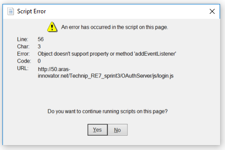

I installed the version 12 and I have no longer the previous message error. But, still can't connect to Aras, I am getting now the following errors :

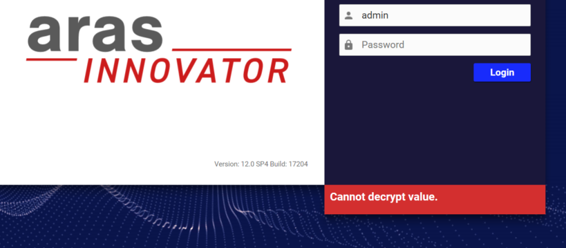

And when I click Yes and I have the following message : Cannot decrypt value
Thanks for the help.
