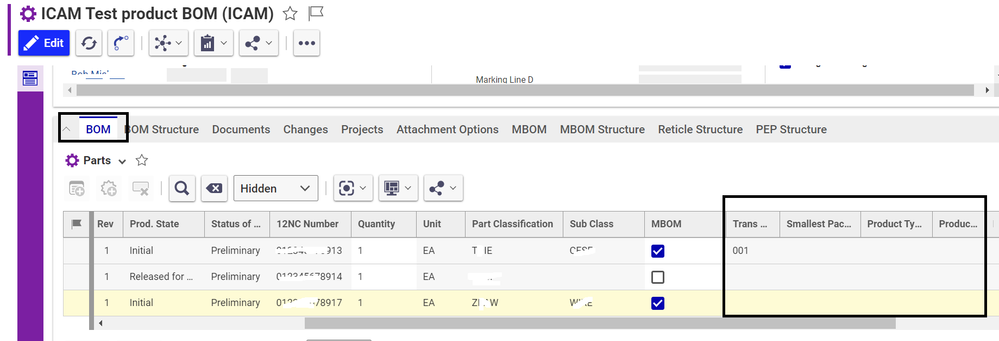

I have a business requirement related to the BOM (Bill of Materials) tab. In my current scenario, there is a need to hide specific columns, illustrated by the black-highlighted sections in the attached screenshot.
Typically, to hide a column, one would navigate through ItemType -> Part -> Property -> and check the Hidden & Hidden2 values. However, in my case, these columns seem to be non-existent in this structure.
I've also attempted to use JavaScript in the formload and formpopulated events to hide the columns, but unfortunately, this approach has not yielded the desired results.
I would greatly appreciate any suggestions or guidance you can provide to address this issue.
columns to hide - Transgroup, smallest pack, product type etc ( highlighted below)

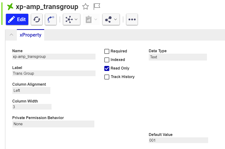

  • Looks like, trans group[] field comes from xProperties. BOM property fields joins xProperties.
