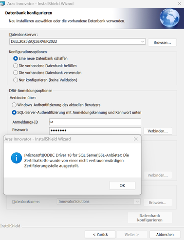

1: Get error at DB connect in the installer:
when add ;TrustServerCertificate=yes to the connect string (DELL2025\SQLSERVER2022;TrustServerCertificate=yes) I can create the DB. I see the DB with all tables in SQl Sever Managment Studio.

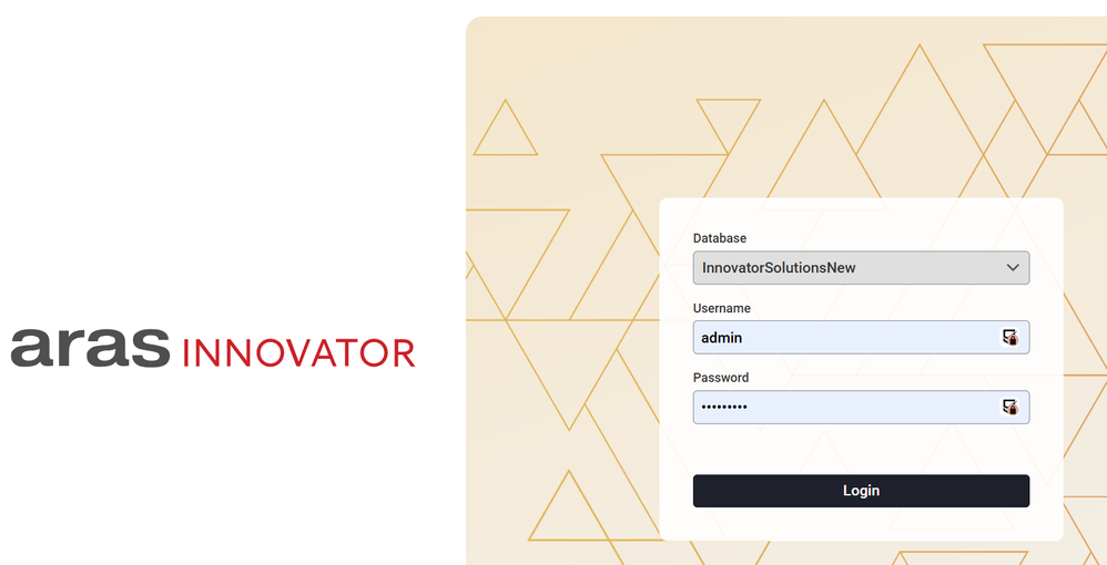

2: When I start Innovator, the login screen show correct and I can select the DB

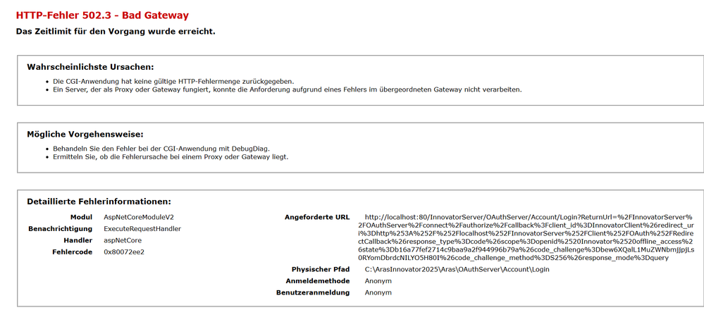

Login attempt does timeout after approx. 3 min with a gateway error
any ideas? .NET, C++ redistributables, ODBC for SQL, all installed.
