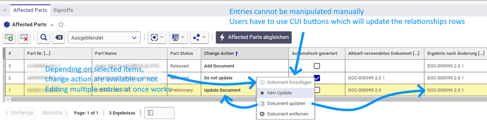

  • Hi community,
    I don´t actively work on this topic, but I always look for ideas regarding this one.
    To keep the discussion active, here some new input.
    I right now work on a custom CM process. It turned out that CUI works shocking well for a custom "impact matrix like" user interface (if we ignore the fact that I spent hours to understand how to edit relationships from CUI tearoff menus cause of missing documentation and literally no similar CUI usage sample in my Innovator...thanks Aras [emoticon:98f842990f454422aa6a04953955f9d9]  ) :
    I wonder if we can reuse this concept for a custom Impact Matrix. CUI is also supported inside TGVs, which could be used to render a multilevel tree.
    A second view could be used for a flat view of the Affected Items as seen above. The "Affected Items" tab is by default hidden cause it´s not secure to manipulate the Affected Items manually. But this additional safety could easily be provided with some custom CUI buttons. Often working with the Affected Items is faster than working with the Impact Matrix. So why not allow both views?
    One obstacle is still how to easy manipulate relationship changes. Maybe we can display them directly as third accordion, but I am not sure.
