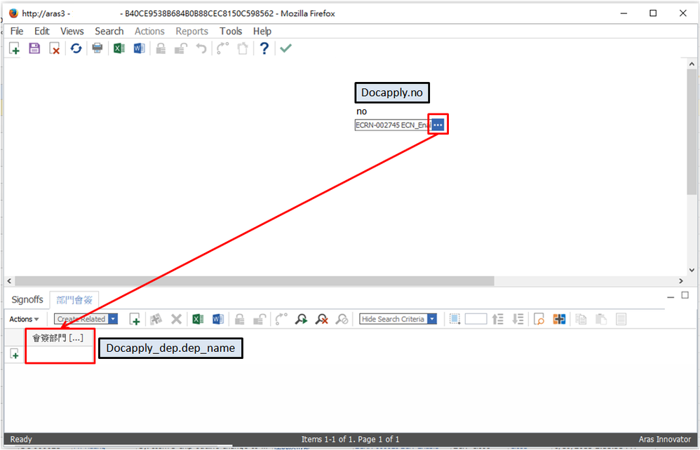

Hi, All.
I have a Itemtype (source) named DocApply.
DocApply has a relationship called DocApply_deplist which connects DocApply to DocApply_dep (related).
I added an onchange event to DocApply's property (no) to bring the related data to DocApply_dep when (no) is changed.
The problem I encounter now is as follows
DocApply_dep has a field with the dep_name data type of Item
When I successfully write the data into DocApply_dep, but the dep_name of the relationship tab on the screen is blank, I want her label to be displayed, but I don't know how to do it, can anyone suggest me?
//Here is the javascript code I wrote
//It is executed in (docapply.no) onchange event
var tabbar = parent.relationships.relTabbar;
      tabID = tabbar.GetTabId("部門會簽");
var currTabID = parent.relationships.currTabID;
var FirstTabID = tabbar.GetTabId("Signoffs");
var tmpItem;
var DocApply_depRelId = top.aras.getItemFromServerByName("RelationshipType","DocApply_deplist","id").node.getAttribute('id');
var dep = "gm,ap,ep,sw,rd,hpla,po,ee,pa,cm,ed,lm,tt,pt,ad_mm,qc,ms_1,it,ad,hr,fa,fc"
if (srcElement.value !== "")
   var qcondition = "<itemtype>Arima_ECR_ECN</itemtype><id>"+ECNid+"</id><dep>"+dep+"</dep>";
   var Depinfo = top.aras.applyMethod("Find_Old_CountersignDep", qcondition);
   Depinfo = Depinfo.replace("<Result>","");
   Depinfo = Depinfo.replace("</Result>","");
   //return-> id:keyed_name,id:keyed_name,...
   var Dep_data = Depinfo.split(",");
   for (var i = 0;i<Dep_data.length ; i++)
      var Dep_info = Dep_data.split(":");
      tmpItem = top.aras.newItem("DocApply_dep");
      top.aras.itemsCache.addItem(tmpItem);
      top.aras.setItemProperty(tmpItem,"dep_name",Dep_info[0]); // id
      var newRelship = top.aras.newRelationship(DocApply_depRelId,parent.item,false,null,tmpItem,"DocApply_dep",false,true,"DocApply_deplist");
if (currTabID !== FirstTabID)
   top.document.frames[2].iframesCollection[tabID].contentWindow.location.reload();

    If somebody knows and can help I would really appreciate that.
    I also tried the following four ways to update and reload,
    but I don't know if it's the wrong way to use it,
    it didn't work for me either, there will be an error message
    //1.
    //parent.relationships.reload()
    //2.
    var parentItm = document.thisItem;
    var parentID = document.itemID;
    var parentAction = 'view'; // or 'view'
    top.aras.uiReShowItem(parentID,parentID,parentAction,'部門會簽');
    //3.
       top.relationships.iframesCollection[tabID].contentWindow.location.reload();
    //4.
    if (aras.getMostTopWindowWithAras(window).frames.relationships)
    {// check "no tabs in tab view"
       var iFramesCollection = aras.getMostTopWindowWithAras(window).frames.relationships.iframesCollection;
       for (var tbId in iFramesCollection)
          var relshipTypeNd = aras.getRelationshipType(tbId);
          var relshipTypeName = aras.getItemProperty(relshipTypeNd.node, "name");
          if(relshipTypeName === "DocApply_deplist") {
             iFramesCollection[tbId].contentWindow.location.reload()
    Can anyone tell me the correct way to use it and the timing?

        Mavis
        hi Michael
        I used try catch to solve this problem...
        I don't think it is a proper solution
        But it can be a reference...
        try
        catch (parent)
