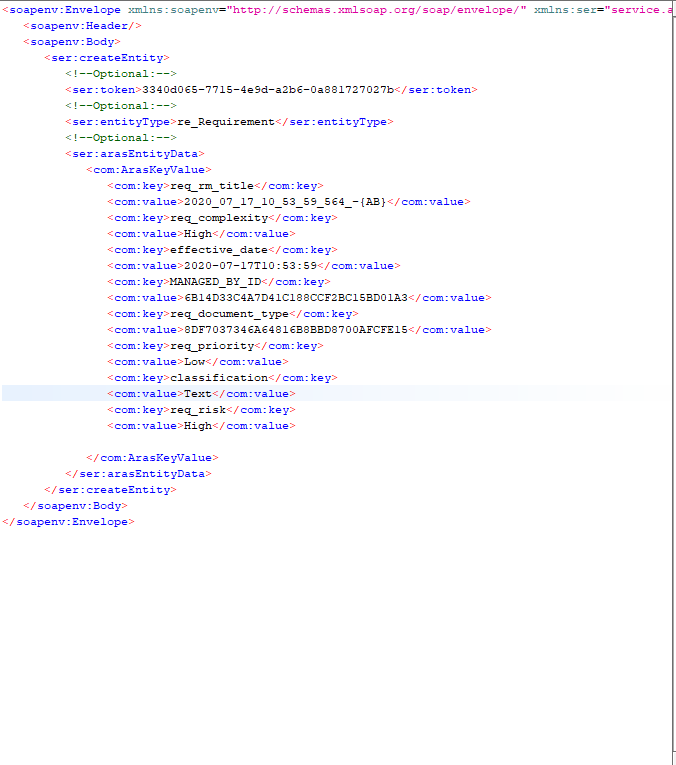

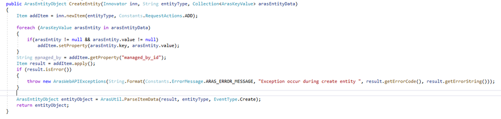

I am trying to create Requirement itemtype by using following C# code:
Input to the function is given in SOAP UI as:
I am getting an error on this for null value in managed_by_id while I have already given value for managed_by_id.The value given for managed_by_id is taken from aras database.(Database record was for a Requirement added through UI).

I am not able to find reason for such failure because of null as I am explicitly passing the value for managed_by_id.

  • Can you debug this method and share the AML query constructed in addItem ?
