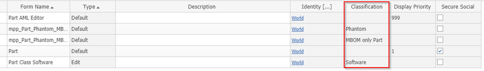

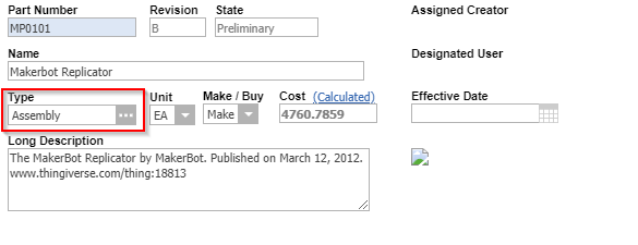

I do not believe it is possible for a classification to have its own icon on the TOC. Users will be able to create a new part, which includes all of your classifications. When creating a new part there is a Type property. Setting this to one of your classifications will make the part being created whichever classification you chose.
Under the Views relationship on part you can specify different forms to load depending on the type of classification you are adding. Once you've done this, if you set a new part to type "design" the appropriate form will immediately be loaded into the part creation tab.
