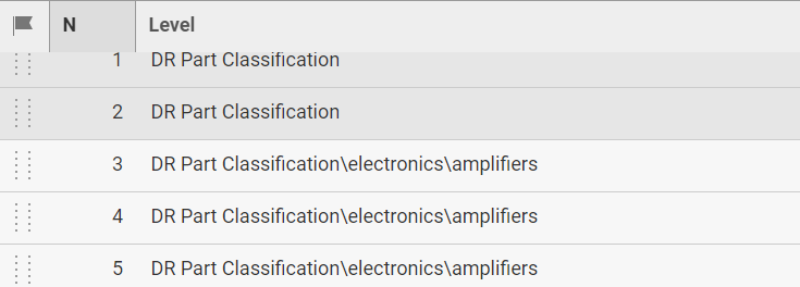

Hi All, I am trying to get level from Xclassification tree can you suggest any way to get that whole path.
please find attached screenshot for your reference i need to get the whole path under level tag from classification tree,

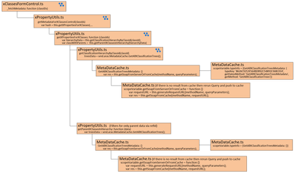

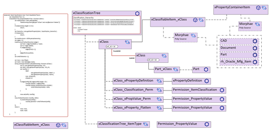

      To support the discussion I have added 2 snaps below. (I think they are pretty close)
      Data Model:
      Javascript Model:
      I hope this helps to support the conversation.
