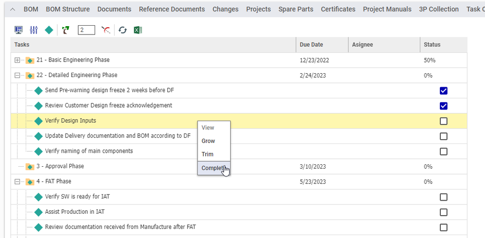

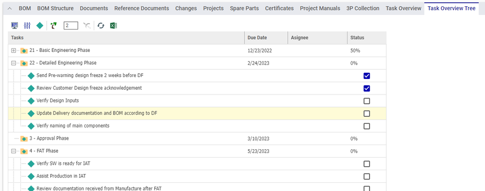

I have created a new query definition and tree grid view to display the structure on a new tab on the Part:
I have also created a custom context menu item with corresponsing method that is intended to set the Done property on the selected task.
The issue i am struggeling with is that i cant get the Item id of the selected row.

var dataObject = tgvGridData.focus[0].row.cells[0].data;
aras.AlertError("Result: " + dataObject);
as shown from the output i get "INVALID_ID_VALUE"
Hope somebody can assist here.

      But, i found the root issue and it was related to the configuration of the Tree Grid View. The "Data Template" on the mapped element was incorrect. When i updated it to "{"id": "{Task.id}", "type": "Task"}" on the Task name property everything worked as intended.
