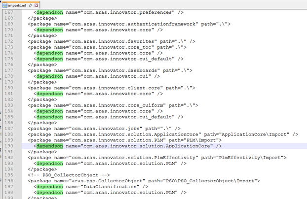

    First, it is important to understand that packaging in Aras is not simply a matter of exporting every modified item. Aras packages are intended to transport customizations and must respect the existing package structure and dependencies. The official Package Import Export Utilities documentation discusses package dependencies, package definitions, and the need to carefully manage referenced items. Another important concept is PackageDependsOn. Aras supports declaring dependencies between packages, and the import process uses these dependencies to determine import order. If Package A depends on Package B, Package B should be imported first. The documentation also notes that if a referenced package or dependency does not exist in the target database, the import may fail because imported items can contain references to items from the dependent package.

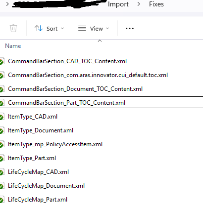

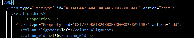

      -> You may be trying to link a Form to an ItemType that already has one (for example, modifying the OOTB Part Form instead of creating a custom Form), or importing the full AML of something that already exists in another package such as Part. Another possibility is importing an ItemType with is_relationship=1 instead of importing the corresponding RelationshipType AML only.
    One common mistake is trying to package a complete AML definition for an item that already exists in another package (for example Core or PLM content). When you are modifying an existing out-of-the-box item, you generally should not re-create the entire item with action="add". Instead, the package should contain only the customization required to update the existing item, typically using action="edit" style AML. These customizations are commonly exported into the Fixes portion of a package rather than as a complete redefinition of the original item. Also remember that a Package Element may belong to only one AML package. This is an explicit restriction documented by Aras to avoid import conflicts when the same element is contained in multiple packages with different definitions. This is another reason why repackaging OOTB content can sometimes lead to unexpected import issues.
    This is particularly valid for TOC customizations. You may have created a new TOC section, but the deployment actually requires modifying an existing OOTB TOC entry. Look at this example where I have fixes for OOTB items I have modified:

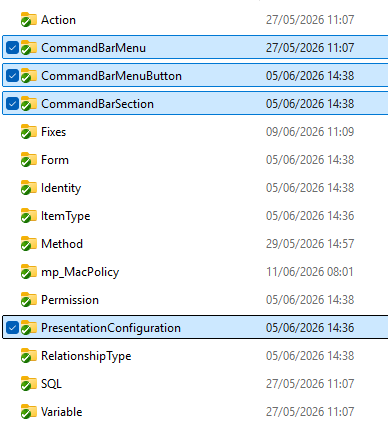

    Don't forget all CommandBar and presentation configuration when adding an Item Type:
