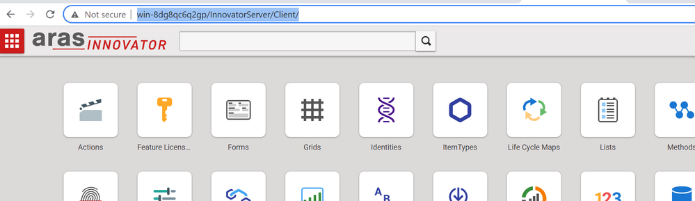

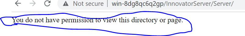

      I am try to access  URL(http://win-8dg8qc6q2gp/InnovatorServer/Server/) getting error.
      I am to login with url(http://win-8dg8qc6q2gp/InnovatorServer/Client/) able to lgin

        Hi Ashok
        Check with your server administrator.
        From the image that you have attached it is clear that the URL (http://win-8dg8qc6q2gp/InnovatorServer/Server/ ) is not correct and the request is not validated.
