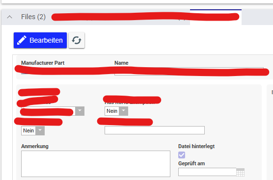

        Maybe some idea for you to copy. Make your own buttons!
        I used aras.uiShowItemInFrameEx to get the target form and added a custom "Edit","Save","Abort" and "Refresh" button by myself:
