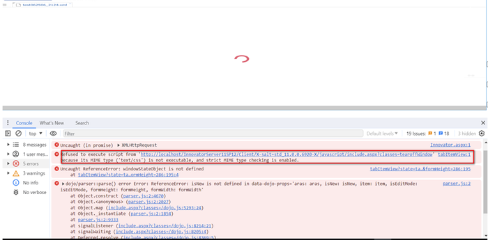

Dear All,
         Apply information security header: X-Content-Type-Options:nosniff   File Upload not working
My Env description as follows:
        1. IIS 10
        2. Aras Innovator 11Sp12

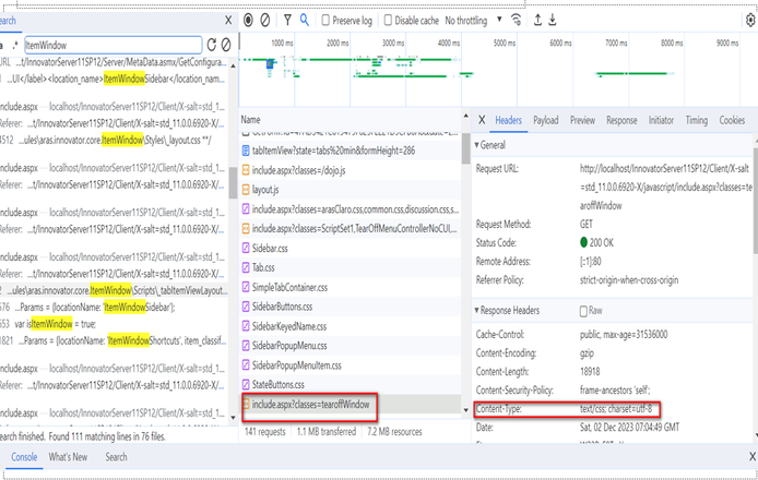

Error Message:
Refused to execute script from 'localhost/.../include.aspx
Because its MINE type ('text/css') is not executable, and strict MIME type checking is enabled.
How to resolve the issue?

      Dear Btredstone,
          But include.aspx is Aras Innovator provide program. It response not correct mine-type.
      HHow to resolve the core program issue?
