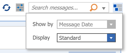

Visual Collaboration , Show By Option disabled.
I have Visual collaboration set up on my Instance however In my Discussion Panel , I would like to Sort my messages
But the Show By Box is disabled. Could someone please help me in figuring out why this is disabled and how I can Enable it.

      I am currently working with Aras 12 SP 4 version. I made a couple of observations regarding the Show By functionality in Aras as follows :
      The Show By Option is enabled on the Discussion Panel for a Particular Item , and you can sort the messages by their date, by conversation or by thread.
      In My discussion page since there are messages belonging to different Items that may or may not be related to each other, Aras disables this particular Option.(Hence it was disabled in my screen shot above).
      However Aras provides a facility to bookmark items, so that they can be followed easily from the my Discussion panel , wherein It again enables the sort functionality. Thanks again for your Help [emoticon:c4563cd7d5574777a71c318021cbbcc8]
