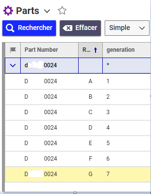

Hello, when I am in the general search grid by putting generation * it works.
But the tgv definition query that I created is in the article at the last revision. The link between the different versions seems to be broken when I search in the part directly. Would adding a "version_id" property in the Part type item allow to reestablish the link in the article. Thank you
