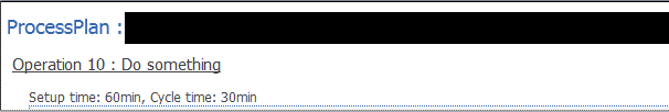

    Displaying the cycle time is one of the first things I would do to solve the task.I made a quick and dirty test, as I also need this customization anyway. But it still needs further testing:
    Take a look at the Method 'mpp_OperationElementRenderer'
    Around line 45 add additional code for displaying the timing in the process plan:
            RenderStartHtmlElement: function(/*WrappedObject*/ schemaElement, /*Object*/ elementState) {
                var startHtml = this.inherited(arguments);
                var detailsButtonContent = elementState.isDetailsEmpty && elementState.isEditable ?
                    this.wrapInTag('', 'img', {class: 'ExpandDetailsButton', src: '../../images/EditItem.svg', title: this.resourceStrings.editDetails}) : '';
                var operationCaption = this.wrapInTag(schemaElement.nodeName + ' ' + schemaElement.getProperty('sort_order') +
                    ' : ' + schemaElement.getProperty('name') + detailsButtonContent, 'div', {class: 'OperationCaption'});
                var timing = "Setup time: " + schemaElement.getProperty('setup_time') + "min, Cycle time: " + schemaElement.getProperty('cycle_time') + "min";
                return startHtml + operationCaption + timing;

      angela Is the code insertion similar if i want to display the cycle time of each step in the operation?
      If I have not understood the whole process incorrectly, the operational cycle time is the sum of the cycle times of the steps right? Is it possible to automatically sum up the cycle times of the steps to calculate the operational cycle time?

      Is it also possible to display the cycle times of the steps in this fashion? Right now it only shows for the operations
  • I haven´t tried it yet, but I am pretty sure Steps can be customized the same way. Just try to get a feeling of how Aras names stuff in Innovator.
    When the Method 'mpp_OperationElementRenderer' renders our Operations, how would you call a Method that renders 'Steps'? :-)
    Quote: "...the operational cycle time is the sum of the cycle times of the steps right?". There is no right or wrong answer, but I would calculate it this way. If you change a step, it has direct influence to the parent levels
    Steps are Relationships of Operations. And Operations are Relationships of ProcessPlans. So I would just rollup this structure.

      Hey Angela, I thought along the same ways and manged to get a hold of mpp_stepelementrenderer method. Have made similar mods there , at least for the WIS so far, and works well (I did however not like the fact that adding a new variable for the timing entered that text in the WIS in the next line to the Step title. So I added the cycle-time property capture in the 'Stepcaption' variable instead - seems to work and nothing has exploded yet. So sticking to it for now)
