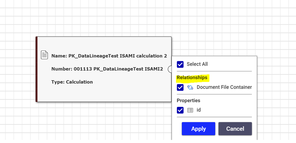

Hide View Cards by default in graph
By default, Both Relationships and Properties View cards are displaying in graph. But I want to hide properties and it should be displayed only on demand.
Can someone help me with this?
  • This is a tricky question. In general most of the time everything is possible in Innovator. But I guess nobody has done something like this for Graph Definitions yet. I am also not very experienced with graphs.
    Best solution is maybe to "untick" Relationships and "Properties" by default instead of ticking them. See  ...\Innovator\Client\Modules\aras.innovator.GraphView\Scripts\ExpandSettingsMenu.ts
    But I am not sure if the result is really worth the effort. It can lead to unwanted side affects. If you really want to try this, use a independent test server.
