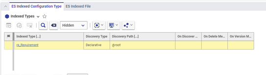

I'm trying to add Requirements as an item type to enterprise search, but ES just won't index requirements and thus they are not found in Enterprise Search.
I have created an Indexed configuration with just one indexed type, re_requirement with a discovery parth of @root. There is no ES Indexed File type.
With the indexed type, I have just added just two properties in addition to the system properties that were automatically added: content and req_title with property types ml_string and string respectively.

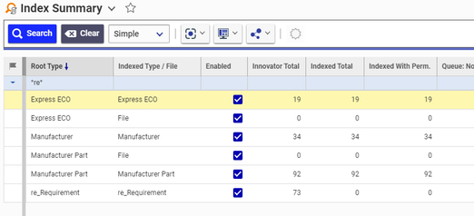

If I look at the Index Summary, I see re_Requirement listed along with an Innovator Total count of 73, but the indexed total remains at zero.
See screenshots below.

      One thing that I did notice is that all 73 requirements (and a smattering of the other items too) were listed in the column "Queue: Failed, To Reprocess". The reprocessing never seems to take place, or always fails. I have found no documentation anyway as to what this queue error means. The crawlers themselves do not register any errors.
