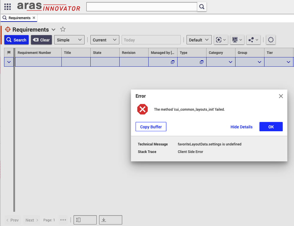

We have found a strange issue with the tool. We have found nothing in the available installation guides and support forums, and we would be very grateful if you could help us figure out the underlying issue here.
We have an installation of Aras Innovator 2024 (Build 14.0.25.40942) that was working for a while, but last week, it started to throw error messages whenever we open any table view (e.g. the Requirement table), or we use any user interface feature related to this view, e.g., change pagination size, select a requirement, etc.
In each case, the error message relates to the favoriteLayoutData settings being not found. More specifically, the following message was emitted:
> The method 'cui_common_layouts_init' failed. favoriteLayoutData.settings is undefined Client Side Error
We have tried to reset the user preferences and try it out with another user, different browsers, and cleaning up locally stored cookies, but the issue persisted. We have also checked the server logs but have not found anything that might be helpful.
The issue breaks the user interface quite severely, making it basically unusable, but have no idea where to look for possible causes.

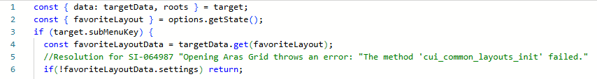

      Aras answered that to me today: worth being tested:
       That patch was intended for Innovator Release 25, and the ‘cui_common_layouts_init’ method has changes between Innovator 25 and Innovator 32. Before pursuing the hotfix further, please do the following as a test:
      1. Open “cui_common_layouts_init’ method for editing
      2. Add the following lines of code under line 4:
      //Resolution for SI-064987 "Opening Aras Grid throws an error: "The method 'cui_common_layouts_init' failed."
      if(!favoriteLayoutData.settings) return;
