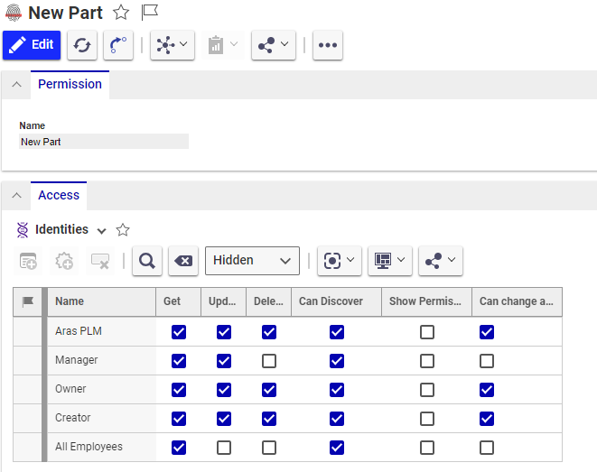

    • asebastian's avatar
      If you can see the parts as Root but not your user account it means that the user account is not a member of an identity which has access to the ItemType. For parts, check out the New Part permission:
      Make sure your user is part of one of these groups (likely all employees).
