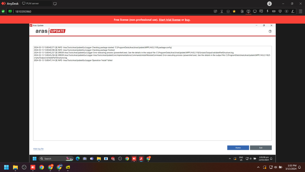

Aras MPP Installation Failure
Description:
During the installation of Aras Manufacturing Process Planning (MPP) using Aras Update, the process abruptly fails with an error. This halts the installation progress, rendering MPP inaccessible for manufacturing process planning and management.
  • asebastian's avatar
    Could you please post the logs that were output at this location:
    C:\ProgramData\Aras\ArasUpdate\MPP.......\validatePartStructure.log?
    Also next time you run Aras Update make sure to do it as Administrator and ensure you have detailed logging enabled when executing an update.
