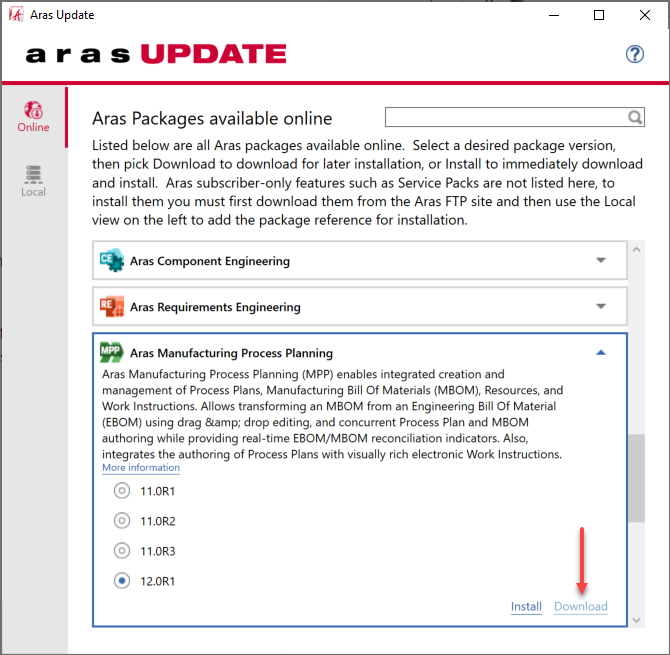

after installing V12SP1, I'm going to install some other applications like Technical Documentation(12.0R1), QMS(12.0R1), MPP(12.0R1)etc.
However, when installing with "Aras Update" tool, it happens error. From log file it records "Aras.Tools.ArasUpdateGui.Logger Required version of Innovator 12.0 None", so, the reason is probably version incompatibility? Will the compatible version of such applications be released soon?

  • Hi Chenze,
    Could you try redownloading the packages before installing them?
    As our QA team finishes testing and approves the applications for new versions of Aras Innovator, we update the list of support versions inside the application package. However, if you've download the application previously, your local copy of the package will still have the old list. Redownloading should fix this problem.
    To answer your second question, you can find the application matrix in our subscriber portal.

  • Hi Christopher,
    many thanks for the quick reply.
    Great, that's the reason of this issue. Now it's solved. The installation is successful, and the matrix is exactly what I mentioned. Thank you so much.
