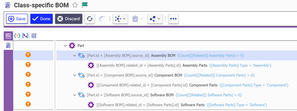

The nodes here basically correspond to the nodes of your Query Definition, so it is possible to have property-specific nodes if you configure your Query in a specific way. In this case, you would need to add a different node to your query for each classification you want to style like the query definition in the screenshot below.
Each of these nodes (Assembly Parts, Component Parts, Software Parts) will then appear in your Graph View Definition and you can style them accordingly.
