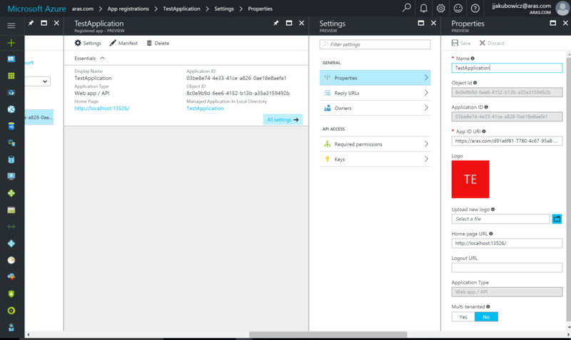

Before getting started in Innovator you must register a client app with Azure Active Directory (AD) using the Power BI App Registration Tool or on the Azure Management Portal. Registering a client application allows you to establish an identity for your Power BI Service and specify permissions to Power BI REST resources.
The Register a Client App page will be helpful in setting up a web app in Azure Active Directory.

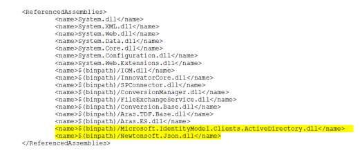

Next you will want to use the NuGet Package Manager Console to download the Azure AD Authentication Library. After installing the library, add the
Microsoft.IdentityModel.Clients.ActiveDirectory.dll to the InnovatorServerbin folder in the Aras Innovator code tree.Open for Edit

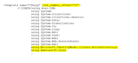

InnovatorServerMethod-Config.xml and add the following lines to referenced assemblies:<name>$(binpath)/Microsoft.IdentityModel.Clients.ActiveDirectory.WindowsForms.dll</name><name>$(binpath)/Newtonsoft.Json.dll</name>.In the same file, search for the
<Template> tag for the language you plan to use and include the Microsoft.IdentityModel.Clients.ActiveDirectory and Newtonsoft.Json namespaces by adding additional using lines. Remember to update the line_number_offset for accurate debugging.The aforementioned DLLs will be used to obtain content from Power BI Service.

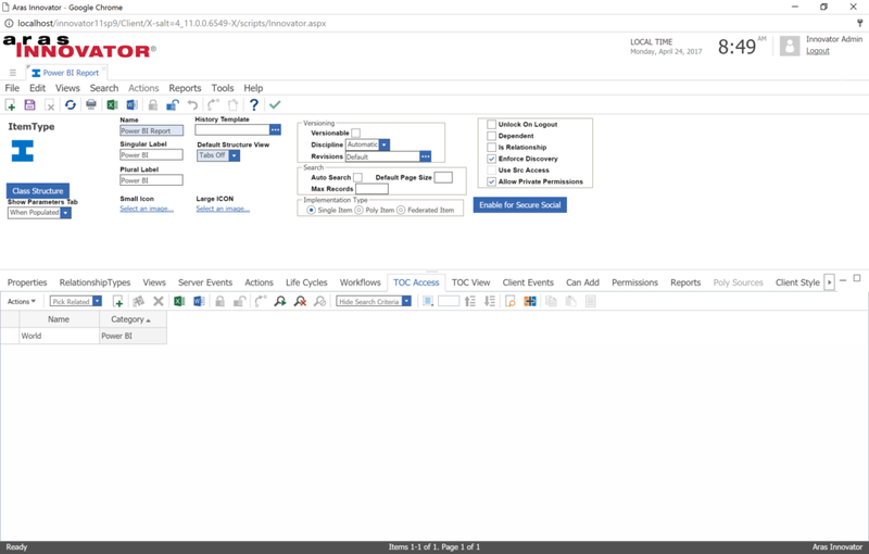

First, in the Categories list item add a new value called Power BI.

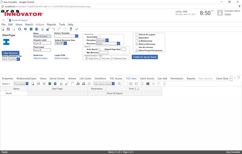

Next, create a new item type called Power BI Report and add a TOC Access and TOC View targeting the form you have just created.

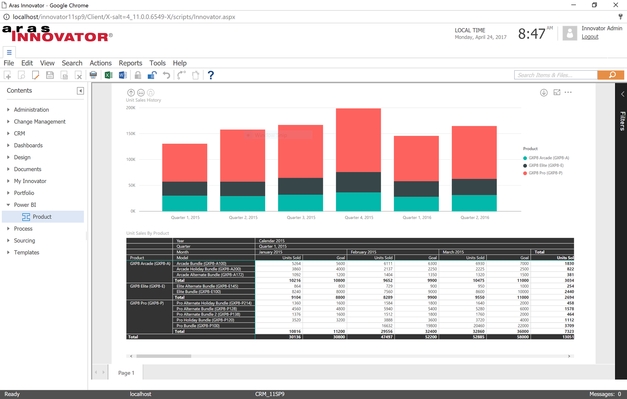

You should now be able to select the Power BI Report item in the TOC and view the Power BI Dashboard in Aras.
