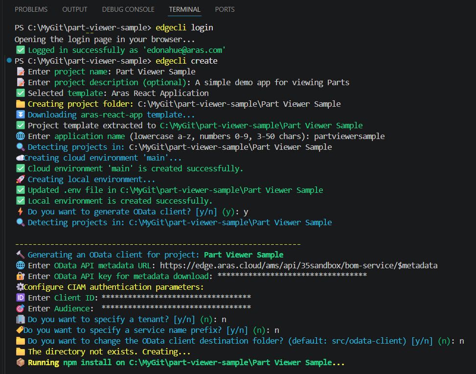

Then create the application:
edgecli create
When prompted:
  1. Enter your project name.
  2. Enter your project description. (optional)
  3. Choose Aras React Application as the project type.
  4. Choose the Use current directory when asked where to install the project.
  5. Enter an application name – lowercase alphanumeric characters only. This will be visible in your application url.
  6. Choose y when asked whether to generate the OData client.
  7. Enter the metadata url for your API – just add /$metadata to the end of the execution endpoint url on the Configure API page of your Edge API.
  8. Enter an API key for your Edge API
  9. If you chose to set up CIAM authentication, you will get two additional prompts:
    • Enter the Client ID for your application in CIAM
    • Enter the Audience ID for your API in CIAM
  10. Choose the default options for the remaining prompts
Edge Builder then lays down the project structure and a default starter app we can build on.

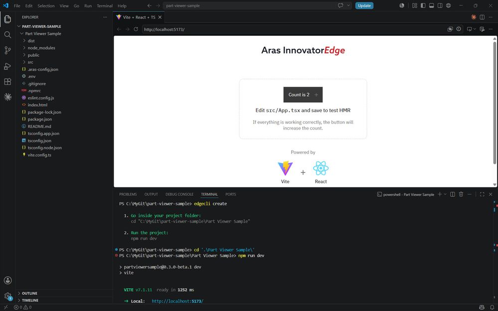

Run the app locally
Before you deploy, it's worth running the app locally to make sure everything is running correctly. Start the development server from your project folder:
npm install
npm run dev
Then open the app in your browser. You should see the default starter app, already connected to your Edge API.
