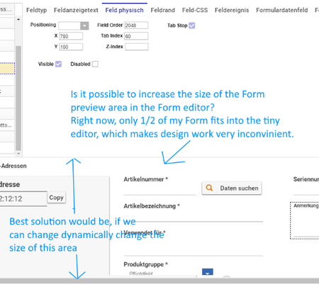

Hi community, does anyone of you know a way to increase the size of the Form WYSIWYG editor? Or even better: How to change the preview size dynamically? By default the preview box is very small and it´s not possible to change the size at all. This is ok for very small Forms, but we are living in the age of ultra high resolution widescreen monitors. So most of the time it´s a big design plus, when UI uses the available space most efficient. But right now we have to design potential full screen Forms literally in box of 10cm / 4inch height. Only alternative is using full custom external html, which I want to avoid for standard tasks. So I would be happy about any tip or idea to improve the way to design Forms! Thanks and best regards! Angela2.5KViews0likes2CommentsWhat is the easiest way to show a placeholder when an item selector is empty?

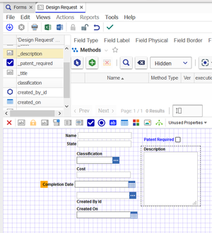

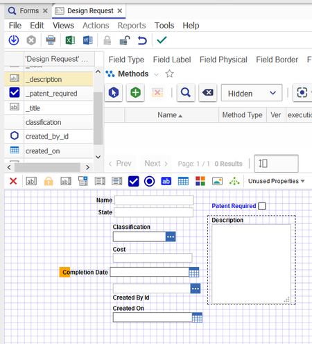

I'd like this added to the body style of the iframe that is loaded in the Forms Editor (html.html_edit_form body.claro.body_edit_form). background-size: 12px 12px; background-image: linear-gradient(to right, #2000ff30 1px, transparent 1px), linear-gradient(to bottom, #2000ff30 1px, #fff 1px); background-repeat: unset; The result is the grid you see. I think this would be a nice UX enhancement that might turn on/off from some control in the editor toolbar.6.1KViews1like4Comments
