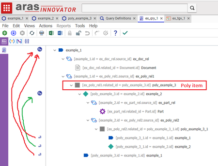

Can't map query elements in tree grid view
Hi, I have been trying to solve a problem I have with using the tree grid views. I can't seem to map certain elements. I wanted to make a recursive tree grid view based on a relation to a poly item where both poly sources had a relationship to the poly item. I was able to set up a query definition that seems to work fine when i run the test query, but certain elements won't map in the tree grid view. I have tried a few different ways to set up the query and while I've mainly worked in aras 11 sp12, I have also tried it in the open version of aras 12. It seems like the tree grid views have issues mapping element when there are multiple instances of "reuse query definition" in the query. Has anyone encountered or solved this problem? Best Regards Rick Query def: Tree grid view:5.4KViews1like2CommentsHow do I set a where statement on a Query Definition against the current date the query is run?
